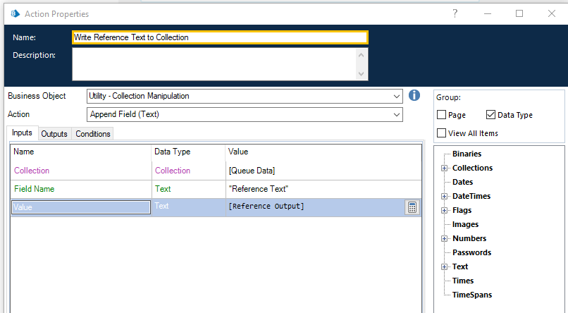

I want to append text to the existing queue collection. I have created the process, which included the steps; read and write text to the collection and update queue data. The process is running well, but there's no update when I check the queue data collection at the end. Here are my steps:

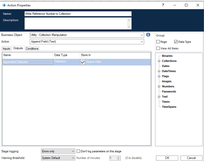

simple question: Did you forgot to re-assing the "Queue Data" collection in the output tab of the "append field" action?

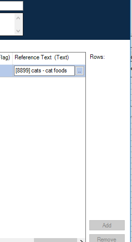

Could you clarify what do you mean by "there's no update when I check the queue data collection at the end" ?
You can view the Reference Text column filled with the Reference Output text once you run the Append field action. There's no need to do Set Data to verify that.

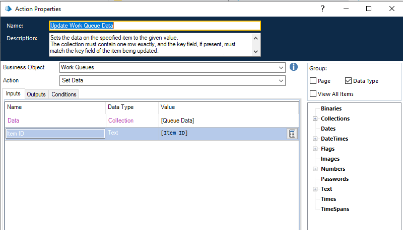

Set Data is used to Update the existing collection data with new data that can be fetched later by doing a Get Item Data
