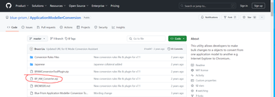

Hi @bruce.liu,
I have tried downloading BP_AM_Converter.zip from below.

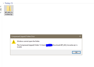

It download fine, but when I tried to extract the contents, it gives me the error as below:
Is this zip file still valid and has all the required contents?
Hi @ronshrestha,
I have just validated the file from Github site and it appeared to be working fine. I would suggest you try downloading the file again or have a go at it from another computer.
Bruce
