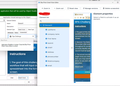

While working with enterprise edition of 7.5 & 7.4.1 with smart vision, i am getting below pop up. but not in v 7.3.1
I am getting this pop up instantly after opening SV as well and while clicking on open existing screenshot.

@Michael_S -  Below snip is from 7.5. SV editor is on RHS. and pop up of "Modeler is Locked "on LHS is not stopping me to work on SV and i think that what new version 7.5 wants usto do that if you have chosen to work on SV, then finish and close the window to work further on  other mode of Application modeller

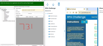

Below is same screen on 7.3.1 where i can keep SV editor open and can add/work on other mode as application modeller is not locked.
