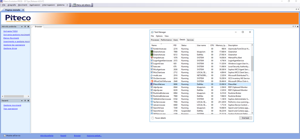

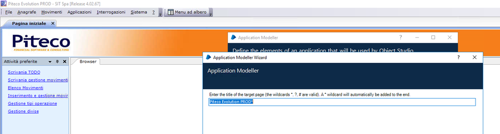

hello Dave, I'm positive the process name is PitecoNet.exe:
The only way BP manages to attach to the app is by chosing "browser-based application (Chrome)" > "a browser which will be already running". As title of the target page I put this:
14400.pngand I haven't modified any of the other settings.

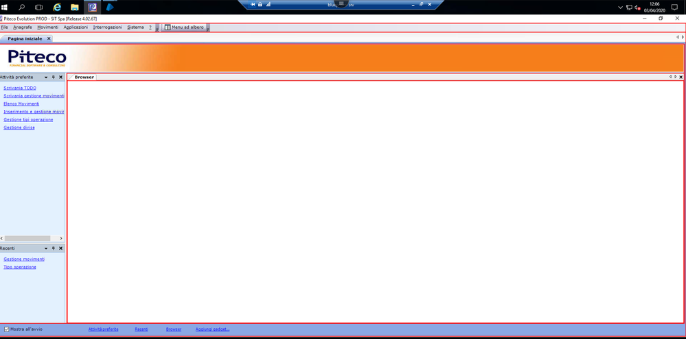

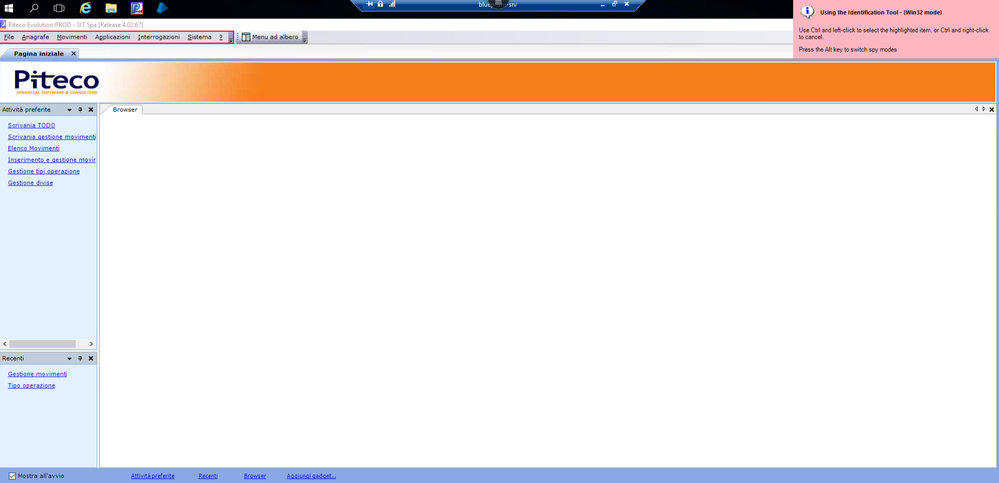

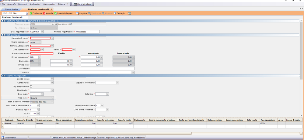

Win32 mode (see below screenshot) doesn't recognize the single buttons in the menù but rather the whole block, and if I select that and straight after I hit "highlight", without changing any configuration, several different parts are highlighted, generating an error on application modeller (see second screenshot)

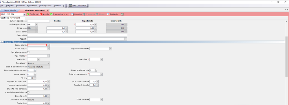

The window of the app I have to use is quite "crowded" as you can see from the screen below and once I spied any of the white boxes, the highlight button always highlights a bunch of them:
When spying any of the white boxes you see in the screenshot above, application modeller at first recognizes correclty the box but then the highlight button always highlights those 5 boxes, generating the error "more than one matching windows found".

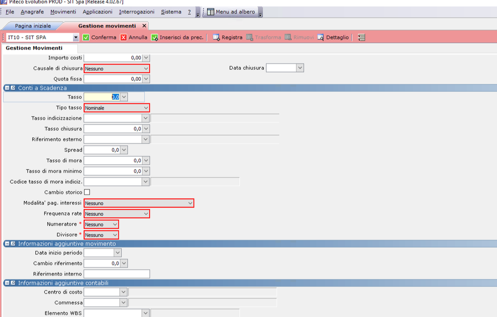

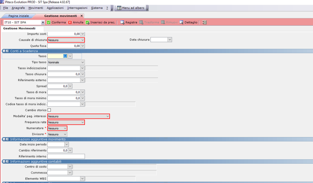

The same happens when I spy and try to highlight the scroll down menus:

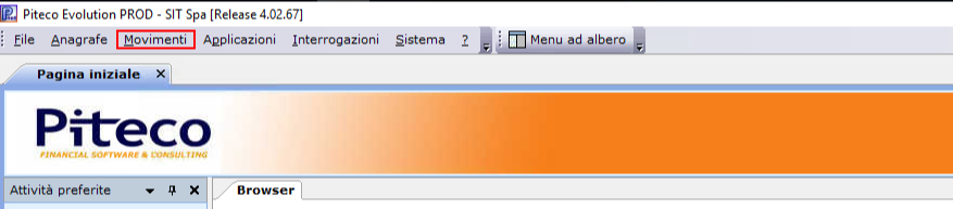

The spy mode "UI Automation" seems more promising: it is able to spy the menù buttons and the white boxes and to highlight them correcly; I noticed that it is quite slow to highlight the elements compared to the other modes (it takes about two seconds), do you think this could generate any issues during the automation process?
Again, however, the scroll down menus are not recognised correcly:
