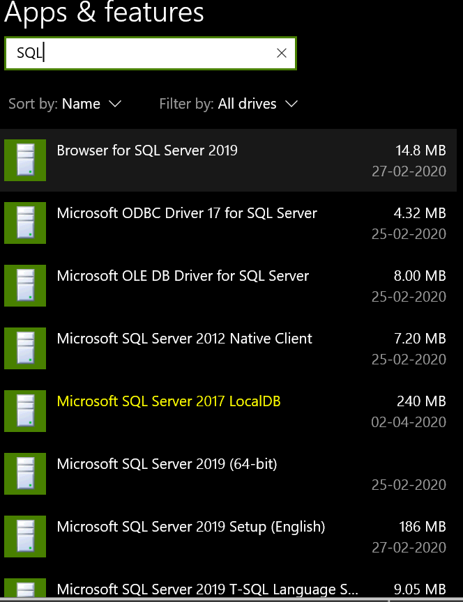

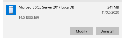

Questions:
- Is this a brand-new installation on the computer for the first time or are you attempting to re-install?
- What operating system are you running on?
- Tip: A screenshot, using Windows search and searching winver will provide this information.
Rationale for asking: The information may help us narrow down the cause of the issue.
Steps to troubleshoot:
- Check whether Microsoft SQL Server 2017 LocalDB is installed
- Tip: Windows Settings > Apps & features
If Microsoft SQL Server 2017 LocalDB is not installed, move to next step:
- Check that Blue Prism has deployed the Microsoft SQL Server 2017 LocalDB installer to your computer

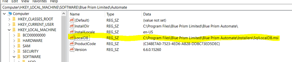

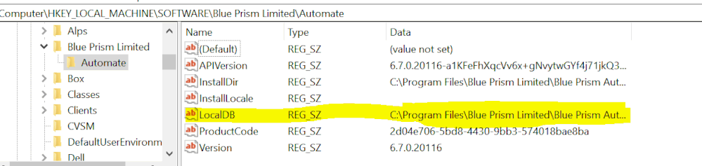

- Check the following Windows registry key is correct:
- Tip: Windows search and searching regedit will bring up the Windows Registry Editor
- Open the Location: Computer\HKEY_LOCAL_MACHINE\SOFTWARE\Blue Prism Limited\Automate
- Review the Data set in the LocalDB registry key
My guess right now is that the LocalDB key exists, but the data is not set correctly to the location of Microsoft SQL Server 2017 LocalDB. If this is the case, populating the Data in the key may resolve, but not actually tell us what caused the issue in the first place.

02-04-20 12:48 PM
1.I have tried several times to install but none of the time it got successful.
2. I am working on Windows 10 OS.
JYI
I do have SQL local db installed-
The key I have checked is given below-
Still getting following error:

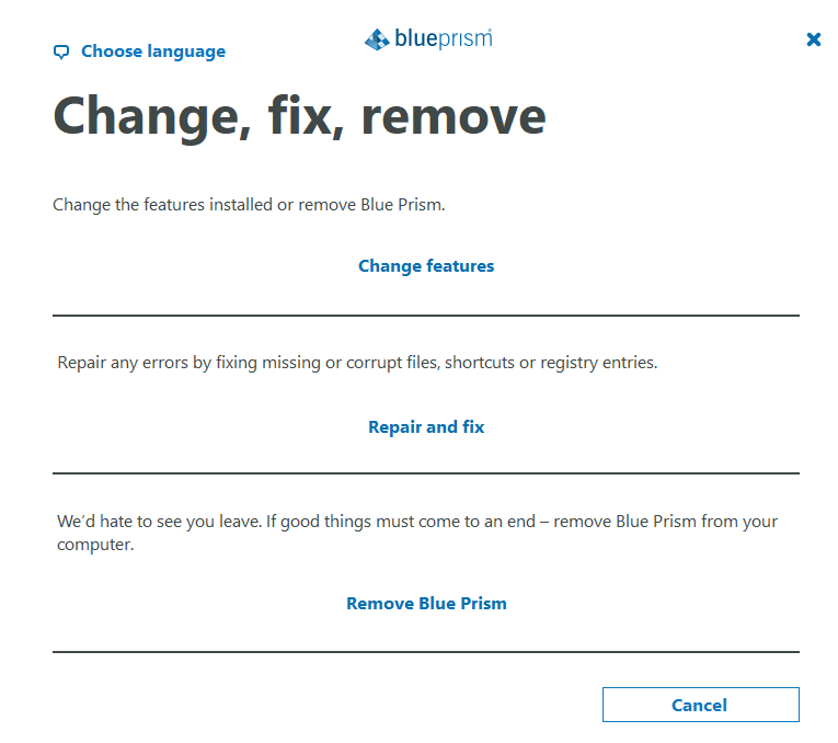

So, we're going to completely strip Blue Prism off your computer by uninstalling it and removing all the files so that when we reinstall, we are trusting that all the right file and folder permissions are setup correctly.
The following steps are extracted from 6.7 Getting started | Blue Prism Trial and Learning Editions (Page 6)
Completely strip and then reinstall Blue Prism:
- Uninstall Blue Prism using the Windows Add or remove programs system settings
- Open the command line (Press Windows+X to open the Power Users menu, and then click "Command Prompt" or "Command Prompt (Admin).")
