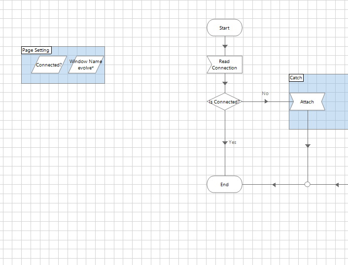

Hi Mats, what is the error which you are getting - I suppose once you have attached the application and relaunching back again - have you detached before relaunching ? Ideally if launched from object studio - it should not require an attach - I would use command line params to launch a web application > Call attach to see if its connected already or not. Also the process name is correct it should be msedge not iexplore.

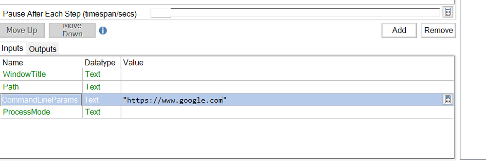

Launching website from Navigate - Launch - Commandline Params:

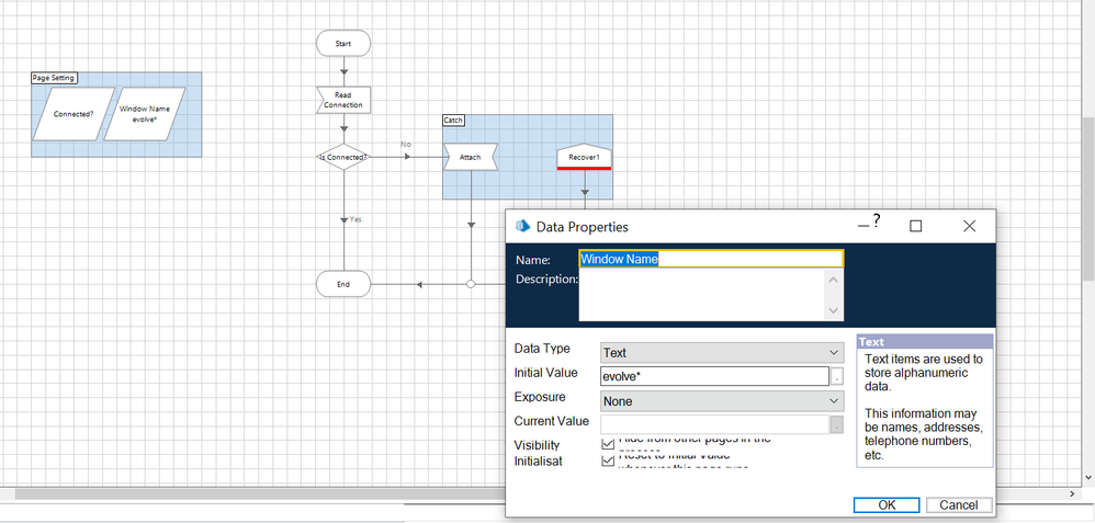

Checking attach - If its already connected - if not, attach :
Also we do have a separate thread (thread can be found here : https://community.blueprism.com/discussion/bp-not-attached-after-launch-of-edge-browser-application?ReturnUrl=%2fcontent%2fallrecentposts) where I did write a detailed steps if you do not wanted to launch from object but start the web app via process and only attach through object, I would copy over the steps as below :

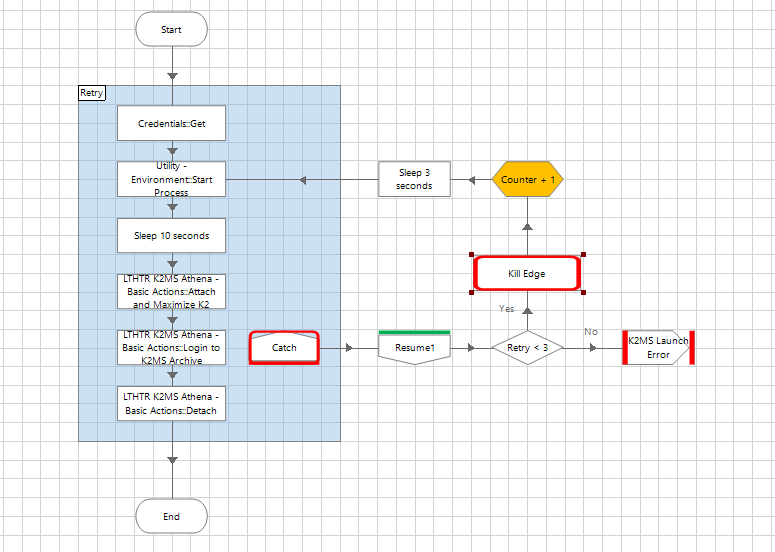

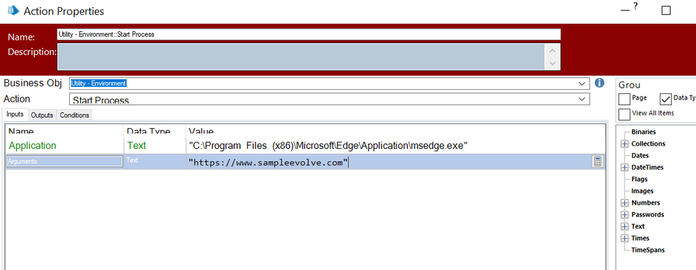

Process > Utility Environment > Start Process > Application and Arguments

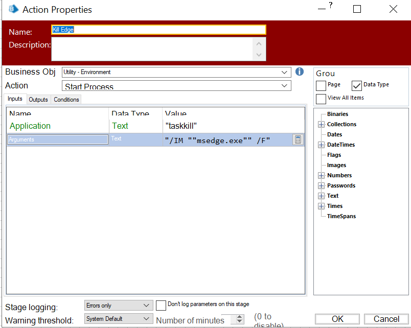

If Launch fails from this block I would kill edge by Taskkill and retry it:
If its attach which is failing - Keep the windows title as wildcard * : something like this and check if its highlighting the outer window- if the window titles are changing and if at least some part of window title is common in each window better to use that as wildcard  :

I have now tried the solution of killing task and start process directly through process with URL and then attaching through the object. Still it fails on next wait stage stage after attach - stating it is 'not connected'.  We already use a wildcard in the attach navigate stage.
Mukeshh_k
Hi Mats - Would you be able to share few screenshots of the Attach Action and relevant Stages for better understanding ?
Mukesh Kumar
MatsØstvig

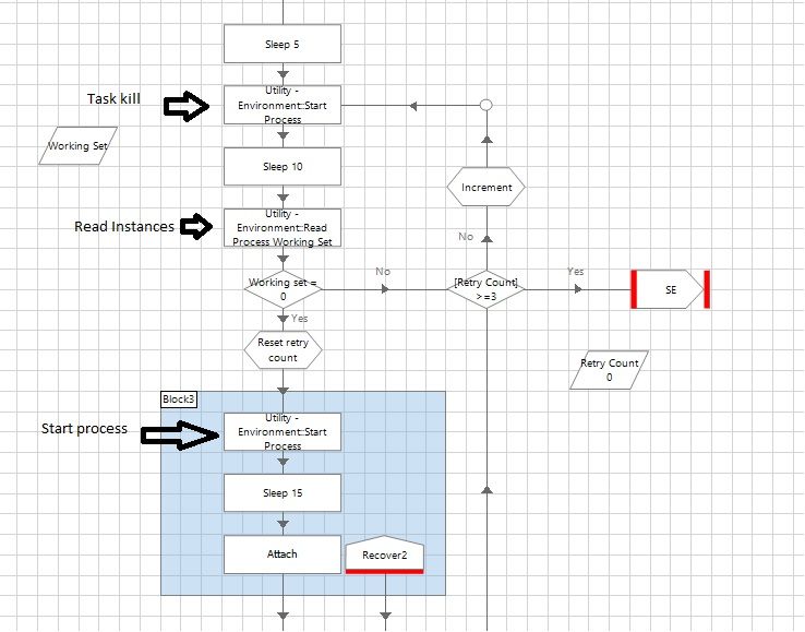

Above is from the process. Using taskkill to close all msedge instances (like you have shown), read if instances is still active (retry killtask if it is.). Start process with application-path and URL. Then run attach(shown below).
Mukeshh_k
Hello Mats - The above flow seems good to me - I just wanted to double check why are you attaching it twice and you said its working in the first attach - if application is getting attached in the first instance itself you dont need to reattach - if you are reattaching it next time - make sure you have detach it before.

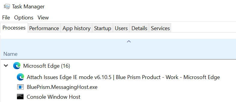

If its failing to attach on the first instance itself - I would go to Task Manager and see what is the task name it is creating - for below example :
I would use full name just for testing and then trim it down to wildcards to make sure what works for me  (Usually here it would be "*Blue Prism Product*" if its not attaching with a shorter form of it.
Also for your case - I would only use Window Title - "*Saksflyt*"

I am only attaching after launching the process using the 'Start process' action which was suggested earlier in this thread.
Also as mentioned - the first case always works, so it is probably not the wildcard which is wrong in the attach stage. The issue seems to be related to the closing down and reopening of edge - which are the actions executed between first and second case as shown in the flow above - and what seems to be causing the error.
