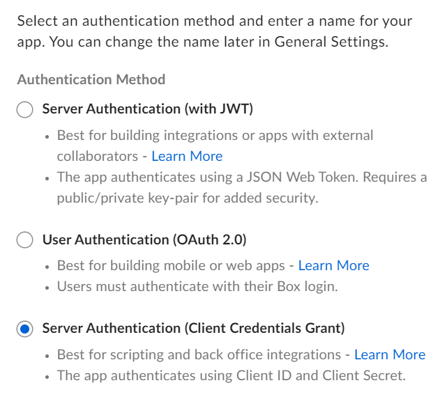

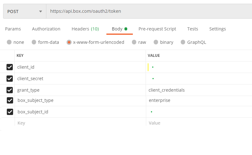

Hi @Chloe MacIntosh,
I tried creating an Box App with Server Auth. Below are the configurations that worked for me to get the access token using POSTMAN.
Reference: https://developer.box.com/guides/authentication/client-credentials

Hi @Shikhar Mishra
Thank you for coming back to me. I am able to successfully retrieve Access Token using Postman, however when I have tried to set up in Blue Prism it is throwing the above error message, so I am unsure what has gone wrong as API set up for BOX in Blue Prism seems aligned to Postman inputs. Do you have any experience with this, or guidance you can offer please?
