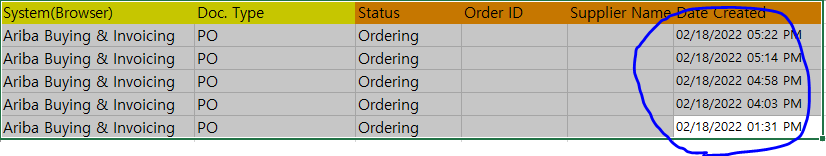

We're trying to use OLEDB to read data from the excel.
The intention is to selectively query data items based on the datetime as below.
The current query we're using is: (but failed)
'select [Order ID], [Status], [Date Created], [Supplier Name] from [sheet1$] where (select CONVERT([Date Created], GETDATE(), 1)) >='&[Data2]
// Data2 is a BP's datetime variable.
Could you correct us with the right query syntax? or Is there anything else to consider?

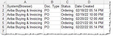

The OLEDB VBO is the correct one to use. The functions used in the SQL query are dependent on the provider being used. In this case I assume you are using the Jet or ACE providers.
Given the example Excel worksheet shown above, you would have to convert your value passed from Blue Prism to a date value using a VBA function like the following:
"SELECT * FROM [Sheet1$] WHERE [Date Created] >= DATEVALUE('" & [Data2] & "')"

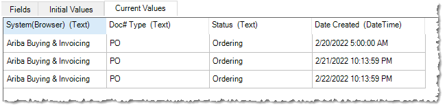

The DATEVALUE function only returns the date portion of the DateTime passed into it so you are telling the query to give you everything from midnight on, for the day specified in the Data2 data item. In the example below, Data2 contained a DateTime of February 20, 2022 2:13 AM.
While the query itself is not affected, somewhere in the conversion from DataTable to collection Blue Prism will convert DateTimes brought into collections to UTC so you will have to do some post manipulation if the DateTimes are relevant to your process.
