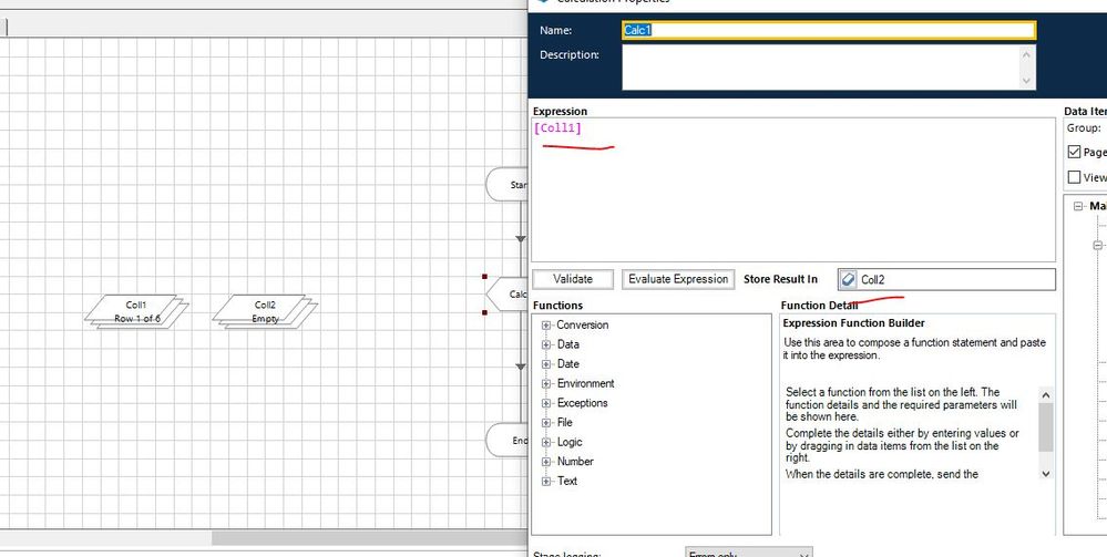

Looking to make a copy of a collection  and searching the Actions in Collection -Manipulation ?
There is a simple way to do that without using any VBO
Just use the calc stage to copy values from one collection to other collection

Hi Nafiz,
The method described merely creates an exact copy of the original collection. It copies all rows, there is no option to copy part of the collection. Of course, there are already VBO's and actions to copy only part of a collection, but the method described by Harshit does not do that.
If you take the time to test Harshit's nice idea, you'll find that if the ToCollection is undefined, it will get all fields and content from the FromCollection. If the ToCollection already has fields, these must be an exact match to the FromCollection fields, otherwise it will throw an exception.

I tried Harshit's idea on one column, but that did not work.
Fastest I could find is to copy the collection using the fast copy above, then remove the columns you don't need with action 'Delete Column' from object 'Utility - Collection Manipulation Extension'.
Alternatively, you could loop through your FromCollection while adding whatever data you need to the ToCollection. This would be a row-by-row operation and therefore perhaps not so fast if you have large collections.
