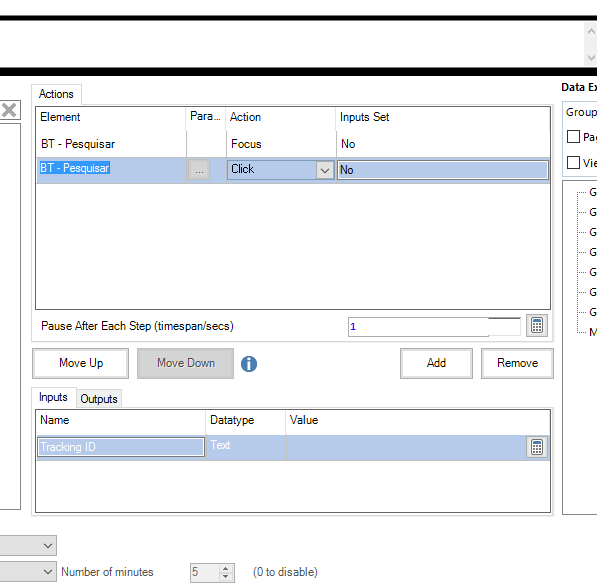

Blue Prism Click doesn't work in 7.1 if the button as javascript
22-08-22 11:04 AM
I upgrade my version to 7.1, i read the release notes that the action of Insert and Invoke Javascript was disabled, but didn`t saw anything talking about elements that as some type on javascript on there attributes could impact the other action like "Click".
I tested on other elements that doesnt have any type o javascript on the attributes, the click works fine, but if it as some JS it doesnt work.
Does anyone had this type of issue? or how to solve ?

I´m not insert or invoke JavaScript ,I know that don't work anymore, the issue is that action "click" doesn´t work, if the element have on there attributes JavaScript. Only in UIA mode i was able to a "click"(Press).
I'm not sure if is a bug or its going to stay this way, because every time you mapping a element and if that element as JavaScript on one of the attributes, the action "click" will not work, and you have to mapping on UIA mode some elements.

24-08-22 09:16 AM
Everything is the same, no change, Blue prism can identify the element, can use the action "Focus", the xpath didn´t change.
The problem is that if the element have some attribute that have some Javascript in it.
It gives the same error, as the ones when you try to use the action Insert/Invoke Javascript.
I solve the problem by mapping on UIA Mode, but the question is, is this suppose to happen on this action of Browser Mode, I didn´t test other action on this button apart of focus.
