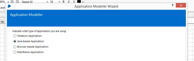

The portal is a JavaScript-based portal. I am launching the Process (IExplore) via the Start Process action and trying to spy the element. But I cannot identify/spy the element as the Attach button is still on the application modeller.
JAB has been enabled as well.
Do I need to do configurations or settings on the browser and Blue Prism Application?
05-12-24 09:58 AM
please check if you have coded like this:
- Launch application using Start process.
-Set up modeler where you have used below option
06-12-24 08:47 AM
On the Application Modeller wizard, did you choose Java-based application?
