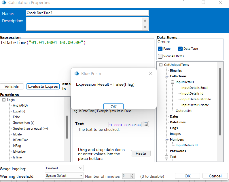

InStr(Trim([dateTime]); "01.01.0001")=0
Empty DateTime variable in Blue Prism results in "01.01.0001 00:00:00" which corresponds to value of Field DateTime.MinValue: DateTime.MinValue Field (System)

You can use IsDate() and IsDateTime() expression to validate the Dates .It would return a flag of true/False .
Hope this helps .

06-07-22 01:49 PM
thats an even better way. Thanks!

Hi Stephan,
Above scenario will not help when you have date or datetime data item.
Would suggest creating an action in Object "Utility - Date and Time Manipulation" with name "DefaultDate", Input for code stage will be the date data item "inputDate" and Output as isDate a flag data item:
isDate = True
if inputDate = nothing
isDate = False
End if
if your element holds date then isDate will be True and if blank date is provided then flag isDate will be False.
