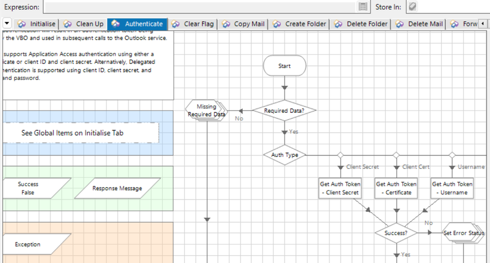

Are you talking about this authentication page -

2. Yes I am referring to same authenticate stage, once the O365 app is registered on Azure. Can we directly use this Authenticate action with Client Secret Token, User ID and Tenant ID? Do we need any additional configuration or internal ssl certificates to establish a connection with graph API?
Sumit
13-07-23 02:13 PM
Hi Sumit,
You can use use Authenticate action with Client Secret, Client ID and Tenant ID.
There are a number of ways to authenticate. You only need to use one of it.
Get Auth Token - Client Secret
Get Auth Token - Certificate
Get Auth Token - Integrated Windows Auth
Get Auth Token - Username and Password
