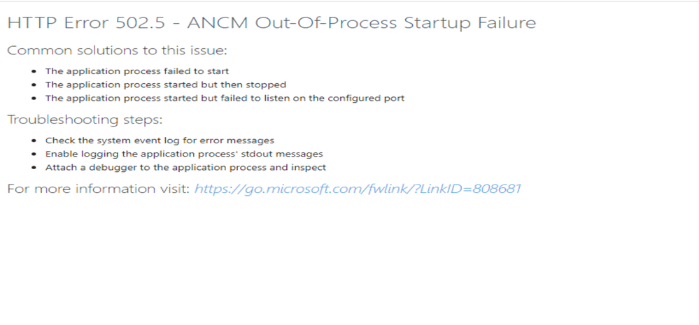

Hola chicos,
instale blue Prism hub 4.6, pero al intentar acceder a https://authentication.local/ me muestra lo siguiente
tienen idea de que es lo que puede estar pasando quedo atento a cualquier ayuda,

Hi Tomas,
We have a couple of Knowledge Base articles related to this scenario and associated Windows error message; have you reviewed these as a first step to see if they help prevent this issue?
- Windows error "HTTP Error 502.5 - ANCM Out-Of-Process Startup Failure" when validating a Hub/Interact installation
- Hub errors "ANCM Out-Of-Process Startup Failure" when browsing through the Hub website

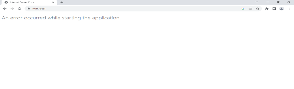

21-11-23 07:49 PM
Hola Steve,
Ahora puedo acceder a https://authentication.local/ pero ahora al ingresar a https://hub.local/ me muestra lo siguiente:
Agradezco mucho tu ayuda
Tomás Salinas
22-11-23 03:21 PM
I'm glad to hear you got past the original 502.5 error. In order to investigate this new error, I would recommend looking into the Windows Event Viewer logs and the Hub logs for more information to determine the problem.
