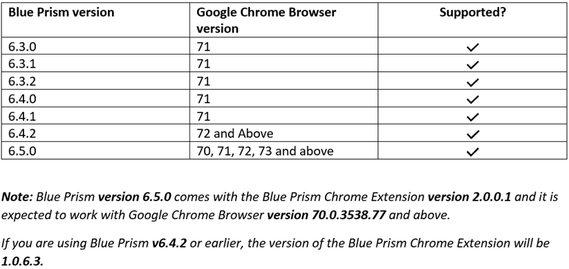

We have faced similar issue ...
Issue Summary - Application elements were able to spy using Chrome -(Version 73+) but not identified after spying in BP v6.
This is not only with particular website ; Infact any other web application are also not able to identified after spying.
Can you try spying different application
More details at - http://portal.blueprism.com/customer-support/support-center#/path/1303017642
I have not tried 6.6 yet...we are still at 6.4 so cant comment on 6.6 issue but for 6.3 it will not work ...
Blue Prism version 6.3.x, 6.4.0 and 6.4.1 supports Google Chrome version 71 for the Browser mode when automating a web-based application. If you are using Google Chrome version 72 and above, you will need to install Blue Prism version 6.4.2 or later.
Hope this helps !
