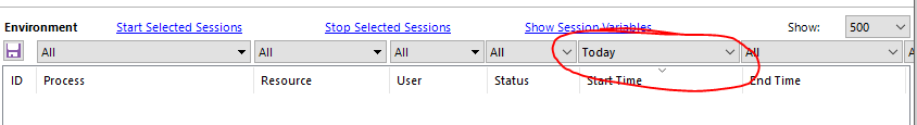

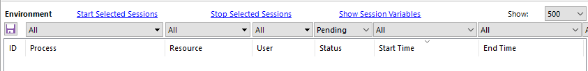

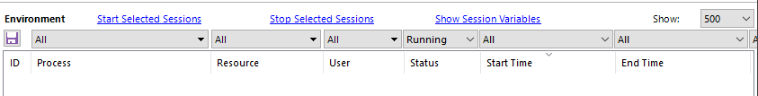

Thanks. So now the thing to check is to see if the issue is as you thought initially (a session that never stopped running) or if it's a pending session.
Go to Control Room > Session Management, and change the Start Time filter from 'Today' to 'All'.
Then try changing the Status filter to 'Running' or 'Pending'. If everything is working correctly, you should see a session show up in one of those two statuses while you have the Start Time filter set to 'All'.
If you find one Pending, then it should be simple enough to right click and delete the pending session.
If you find one Running, then I'd try restarting the Runtime Resource to force the session to terminate. Note that often when I do this, the session may not actually terminate until the Runtime Resource reconnects.
