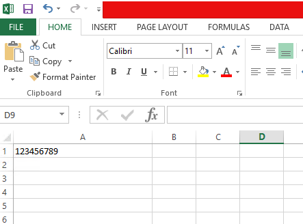

This is regarding issue in Excel
How to add 1 at the end of the number so the length becomes 10 in Excel via blueprism logic
Eg: Existing number in Excel: 123456789
After adding one at the end: 1234567891
Pls advise on this how to perform

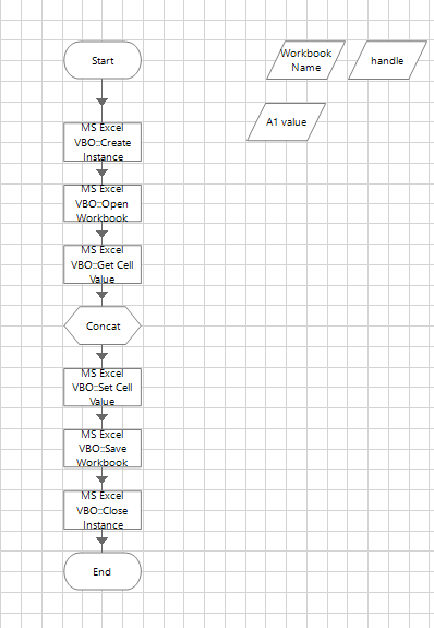

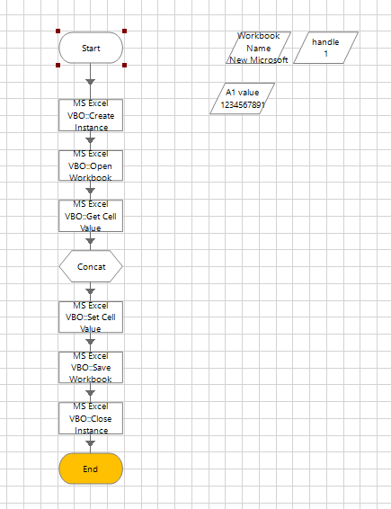

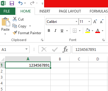

HI,
Use below logic for example,
Excel data for example as per your request and modify the logic as per your file if its required.
BP logic
