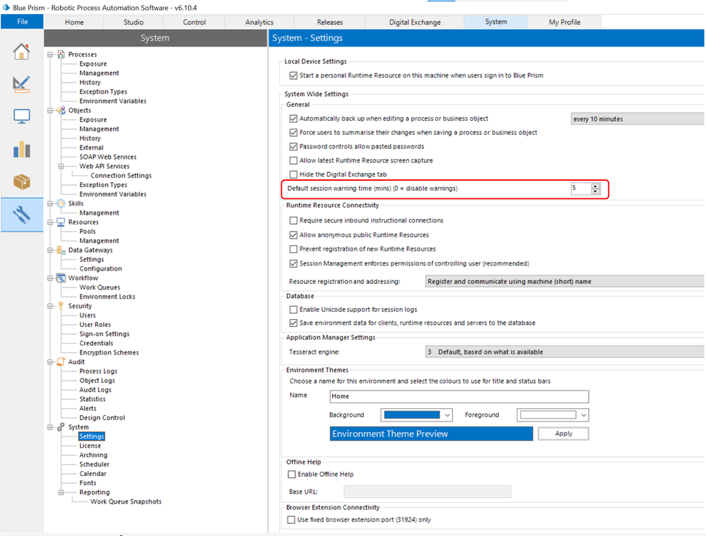

The warning state indicates that an action is taking longer than normal to complete. These can be a few scenarios that might cause an unwanted warning stage such as infinite loops, if object tries to attach to an application but is taking a longer time or if a large file needs to be handled at times.
I would suggest two things here. First you can try and increase the warning threshold time from the System tab as shown below from the default 5 min which will work for all stages in all processes/objects:

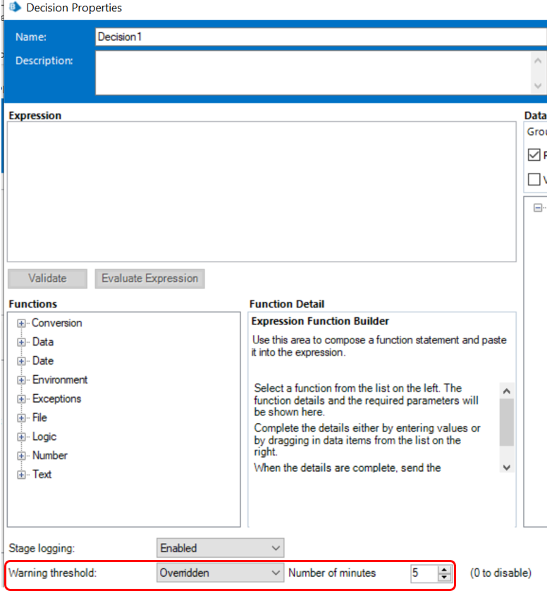

Secondly, check your log viewer for the session where you see this issue and identify which stage is causing it. You can also override the warning threshold for that particular stage from the stage properties after double clicking on it in Process/Object studio and changing the warning threshold to 'Overridden' state and providing the minutes parameter:
