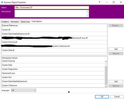

I get the following error
Compiler error at line 0: The type name 'DataTable' could not be found in the namespace 'System.Data'. This type has been forwarded to assembly 'System.Data.Common, Version=0.0.0.0, Culture=neutral, PublicKeyToken=b03f5f7f11d50a3a' Consider adding a reference to that assembly.
I have system.data in code options but it seems like it defaults to an old version.

Hi, I have seen this issue before.
Can you please confirm you're using the correct version of the .NET framework in your environment? Sometimes, Blue Prism might default to an older version of the framework, which might be causing the issue.

How do i see what version i am using?

I have .NET 4.8.1 installed But if Blue prism defaults to an older version i need to tell it to use the new version somehow

We are using blue prism 7.3.1 so i will try to install .net 4.8

In the end i made it in visual studio and ran it as "Start Process Read Stderr and Stdout" from Utility - Environment
