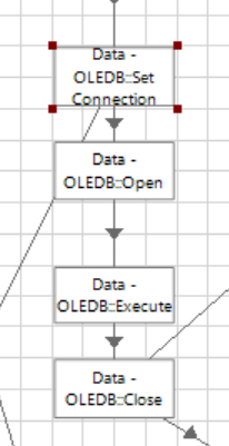

We use Common - OLEDB - ExecuteQuery, with an update query. This causes ,  memory error, specifically, a C0000005 error is an access violation error caused by a buffer overrun. What could be the solution to this ? Is there any alternative to this ?

Hi , But still this didnt work in my bot. Thanks Lakshmi Narayana for looking into this. Can you share with me the connection string and code flow so that I can check with mine? Kindly take a look at mine.

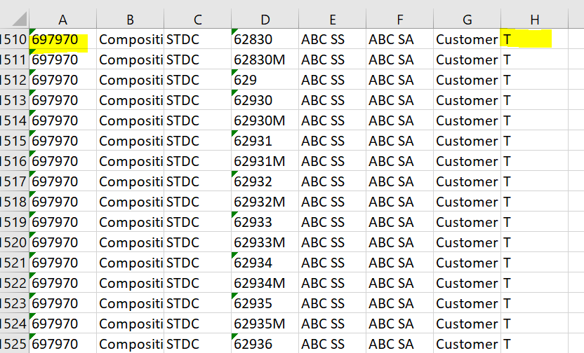

If possible can you share the sample file with some dummy data (replacing any sensitive data )

Here you go...

Hi
I have tested with your file and it successfully updated the value
but this time i used single quotes for the number as it threw error stating datatype mismatch
UPDATE [Sheet1$] SET [IGNORE] = 'T' WHERE [AGREEMENT ID] = '697970'
 tested with two values both are updated
Can you try removing the IMEX=1 in connection string
if possible try this connection string "Provider=Microsoft.ACE.OLEDB.12.0;Data Source="&[Input File Name With Path]&";Extended Properties=""Excel 12.0 Xml;HDR=YES"";"
