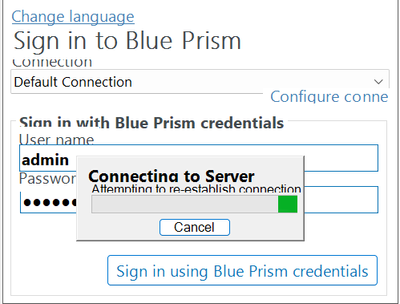

Can't establish connection between client and server
I've been trying to log in to the Blue Prism Client, but this window appears, and nothing happens.
Just to clarify:
  • The BP Client is running on Windows 11 23H2.
  • The BP Server is running on Windows Server 2022.
  • The required ports are open.
  • I've deleted the configuration files and reinstalled BP multiple times on the client machine.
  • The BP Service is running.
  • There are two BP Servers behind a load balancer. Both machines launch the BP Service, and the client connects to one of them using a round-robin method.
  • The connection is established (a message appears at the bottom of the login form), but it keeps trying to log in without success.
Thank you for your attention.

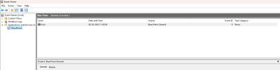

If possible can you please check the Windows Event Viewer logs for the timestamp of the BP login

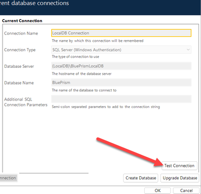

When you try to configure the connection, Did you get chance to  test the connection?
Below screenshot is just for reference i took the screenshot from the learning edition . you need to select appropriatley based on how you want to connect client to the server,

Hi!
Yes, I did it. It appears a window with the message "Connection valid".

Hello!
I'm facing this issue with two machines. They're connected to a load balacing domain.
BP shows this error and, sometimes, it throws a popup telling that there's an error at referencing the server. Most of the time, it justs remains trying to connecting the server.
Best regards.
