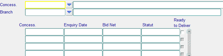

The process is being well attached to the Object Modeller and the the spying is realized with java mode : (moment of spying is highlighted in yellow)
However, the issue comes when trying to highlight the spied element :
==> Working with the element is not possible ==> the application modeller is based on "Java-based-application"

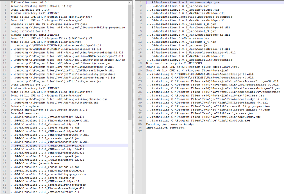

I have installed Java Access Bridge, and activated it from control panel and rebooted the machine many times (BPJabInstaller) ==> Fail
I have also tested with JavaFerret and JavaMonkey but failed too due to no recorded java events ( document used)

EDIT :
log of JAB installation :

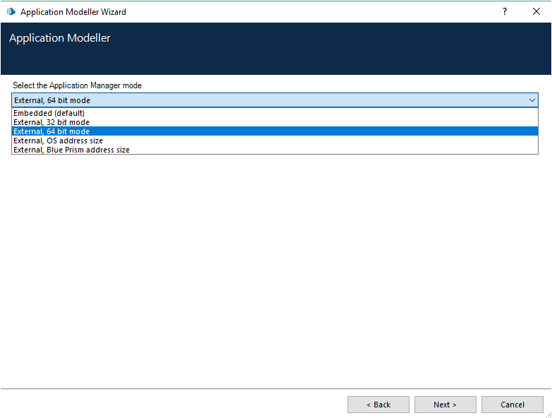

Have you set 64 bit from application manager mode dropdown ?
I hope your problem will resolve after changing above setting.

Hello Nilesh,
Thank you for responding.
I have changed the application manager type to 64bits, but the issue is still there.
