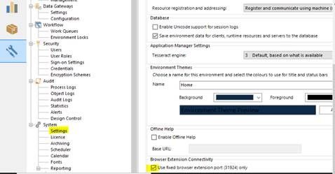

You will need to enable Enable Browser Extension Connectivity settings in all the BP V6.10.1 environments. if, it is unchecked. This is something developers from my team found out so kudos to them
@PraveenAllu  You may already know this, but the web connectivity setting that you mentioned being unchecked is the newest functionality. If the box is checked, that means you’re using fixed port which is the older design in blue prism that causes Firefox and chrome to conflict with each other and stuff like that. There have been a number of web automation issues in the past few versions of blue prism that they’ve been working to solve (most are fixed) and that effort is all toward making it so we can leave that box unchecked so that blue prism can dynamically determine the port number to use. When it is checked, it’s used something like port 31294 or something like that​​ all the time. I’m on my phone at the moment so I can’t look that up at the moment. I just wanted to reply so that you’re aware that the box being checked or unchecked should technically both work, and if one doesn’t then there is a problem with the environment or blue prism.

2. We have begun to avoid using Kill Process on the browser because Blue Prism for a while has had difficulty with properly releasing the port used to communicate with the browser in some situations. We have an action that more gracefully closes MS Edge whenever it needs to be closed by using the three dots at the top right and then clicking Close inside the context menu popup.
3. We use Fixed Port mode. I have not been testing or using Ephemeral Port mode at all for months now because I just haven't had time for testing outside of my normal work.
