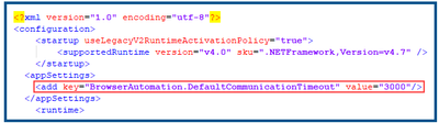

Changing this parameter in Automate.exe.config didn't work as well.
