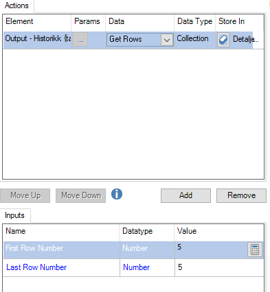

Thanks for your answer Amlan!
I found out that the problem with the "timeout" is related to "empty/blank" rows in the table the application is sending out.
--> By using the UI-spy mode in Chrome browser mode it is possible to read enitre rows and put them in a collection - though it only works with rows that are not "blank".
I does not fix the original problem as I need to specify for each table type which row to store in the collection - but far much better than reading the entire text.
If anyone got a better way to solve this, please shout out! :)
