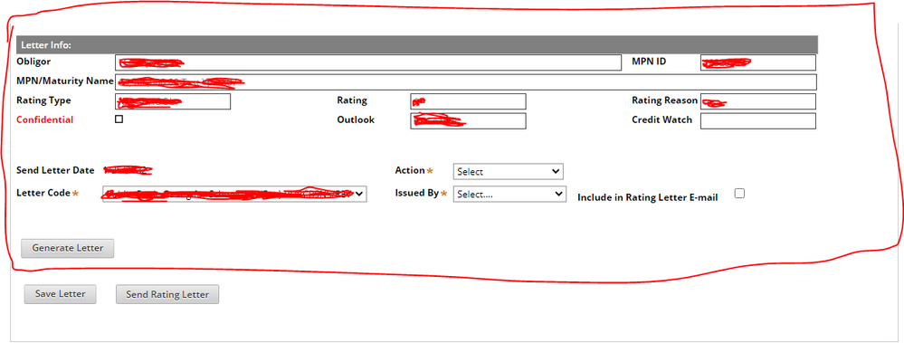

Hi I had attached a screen shot. Since this is an internal app, I had to clear out the data. The boundary in red - when I spy it, it show as a web table. Hope this help to narrow down as to the cause of the issue I am encountering.
