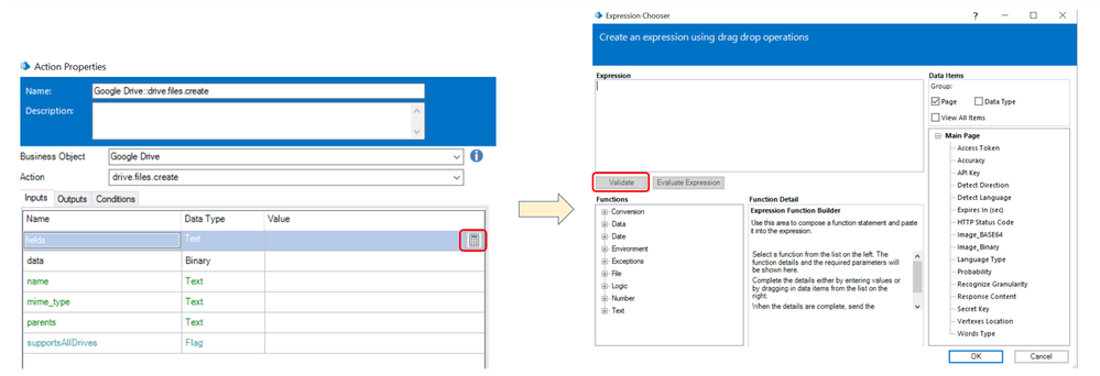

I configured everything you stated above
Let's say I have one parent and my parent id is xyz
This is my action stage configuration
And the error I am getting is
Which configuration is the mistake?
Disha Kulkarni

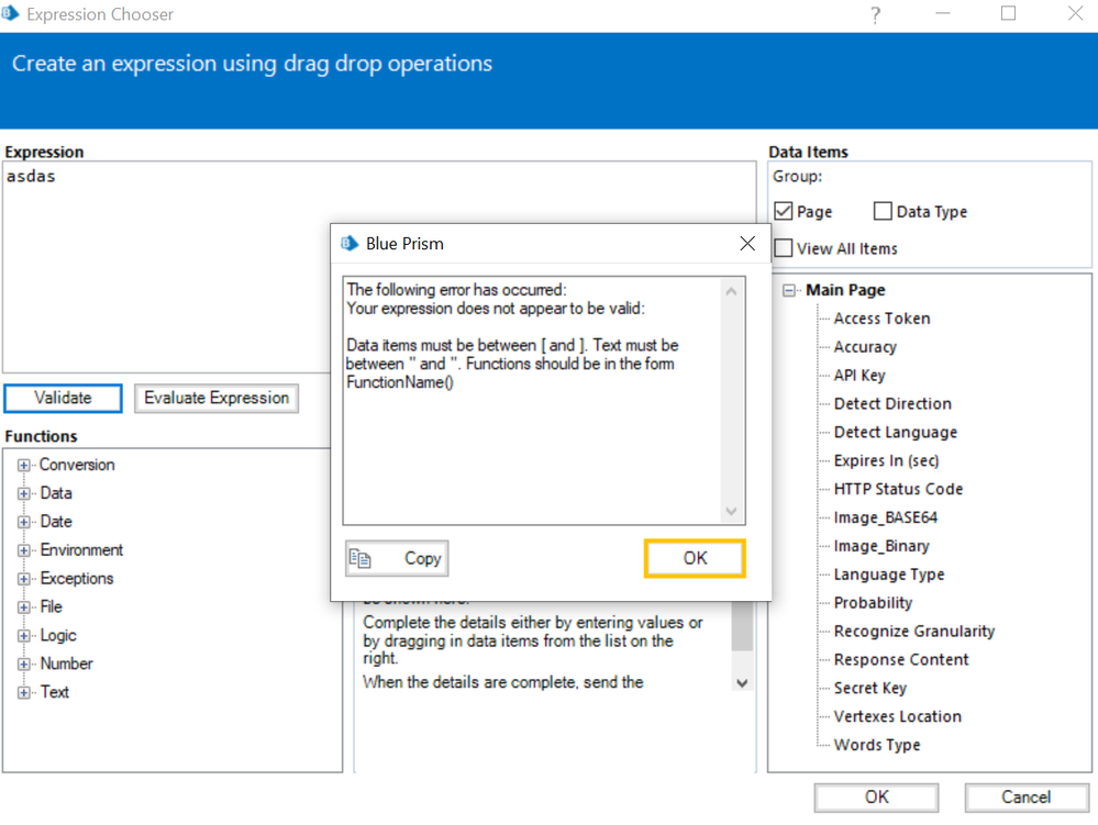

Hello Disha,
Can you check once for each of the parameter, if the syntax is correct or not. You can do this by clicking on the Calculator symbol beside each parameter one by one and the when the Expression wizard opens up, click on the 'Validate' button. That will help you to isolate the issue like at which parameter you have any issue.
You can show us the exact parameter value where you are getting this error that way.
If there is an error with the expression, then upon clicking on the 'Validate' button, you will get the same exception message:
My guess is your issue lies with the 'Parents' field although I cannot tell for sure as the entire text is not completely visible in your screenshot.
Hope it helps you out and if my solution resolves your query, then please mark it as the best answer
