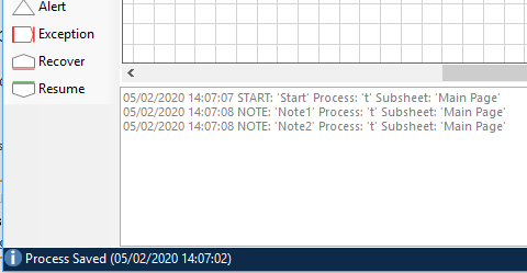

Hi Jianmei,
If you have disabled logging on the stages, then no logs for these stages will be committed to the Blue Prism database and therefore will not appear in the Session Log.
I believe you are referring to the log messages area of Process / Object Studio and looks like the below:
This is displayed on in Process / Object Studio during debugging or running of a process through Studio, regardless of the stage logging option selected. It is there to help with debugging.
If you are enquiring about something else, please provide further information.
