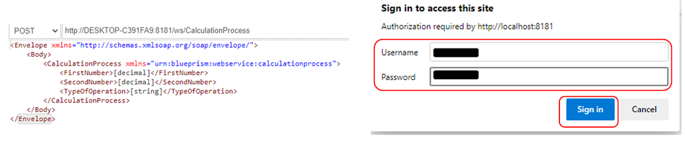

Now in order to consume this process, you first need to generate the SOAP web schema envelope which will be passed along with the API request. To easily generate the web schema, first click on the process link and then you can use a small extension on your chrome called 'Wizzdler'. Once installed, click on the Wizdler icon which will prompt the web schema definition link as shown below:
Upon clicking on the link, endpoint and the associated SOAP envelop will be generated. Here you need to replace the placeholders with values if your process has startup parameters or argument. In my case you can see [string] and [decimal] which can be tested directly using Wizdler.
Once the values are replaced and the authentication parameters are provided, you can see how my request body looks like:
Once I click on Go, I can see the response:
