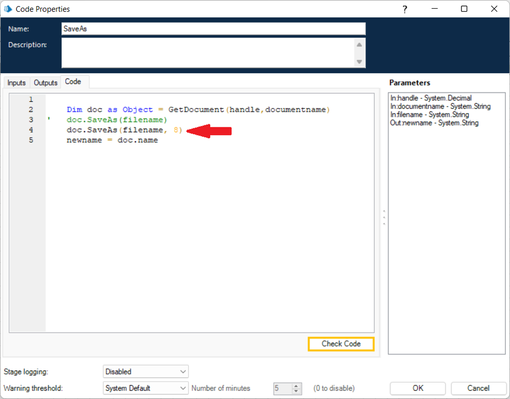

@Denis__Dennehy is spot on with his explanation. Make a duplicate of the existing Save As action in the MS Word VBO and name it Save As HTML. After that, open the Code stage on the page and change it to look like this:
The number 8, that we've added to the function, is the magic number for saving a DOCX as HTML. It will also take any images in your Word document and embed them within the HTML in MIME format.
