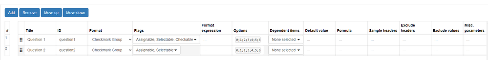

I have this questionnaire with checkbox ratings from 0-10 for each question. I cannot get to assign regions to the checkmark groups.
I have tried different settings in the DFD.
But when I'm in Data Verification and try to assign the regions for each checkbox I get error "Invalid Model State".
Has anyone encounterd the same problem and got a solution to this? Or do I need to use a complete different format in the DFD?
