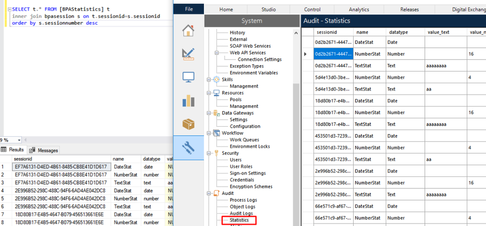

Hi,  when I choose 'Statistic - Store the contents of this data item in the database for reporting purpose' in Data Item Exposure, how and where can I retrieve the data value from database?   Thanks.

Hi Gary - that feature is a relic from BP v1 that should probably be retired, so please ignore it. I'll make a request for it to be retired - I suspect it's been left in for backwards compatibility but I'd be amazed if anyone is using it. The idea predates work queues and was intended as a way to persist data item values between sessions, almost like an updatable environment variable.

I also had a play to remind myself how it worked, and I was wrong to say statistics are persisted between sessions. It's just a means of recording the current value of a data item within the context of one session. The UI in System>Audit>Statistics is pretty much a display of the BPAStatistics table, and as such of very little practical use.
24167.png​​
