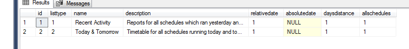

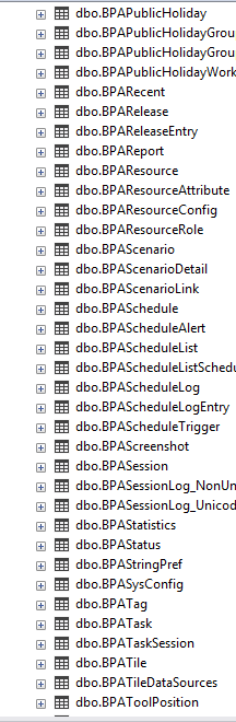

07-07-19 03:14 PM
It's in BPAScheduleList

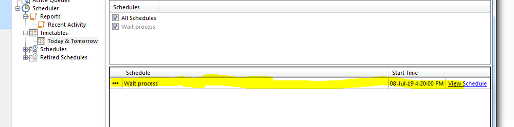

08-07-19 08:00 AM
Hi David,
Thank you,
But the problem is i can only get name of the list not the values of " Today & Tomorrow "
What i was looking for is Values inside Today and Tomorrow ,
Here is an Example screen shot
wait process (example ) is schedueled to run everyday at 4 pm how can i get that value in database

09-07-19 06:25 AM
Blue Prism queries on various 'Schedule' specific tables and dynamically generates the timetable for future runs. "Today & Tomorrow" is the default timetable provided when Blue Prism is installed, but you can configure custom timetables in Scheduler >> Timetables to look at scheduled runs for X days in future against all or specific schedules you have.
