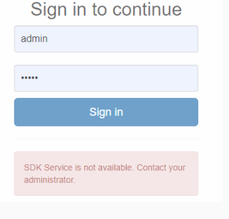

06-06-23 02:36 AM
This link is not opening for me, can you help me? I'm having the same problem, in the Application Pools configuration I'm not putting a user linked to AD and he doesn't follow. Is it possible to set a local system configuration?

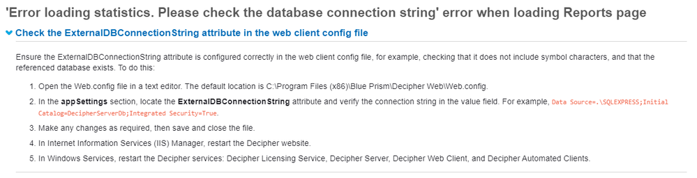

06-06-23 08:11 AM
Hi Jonathan,
Sorry, we've updated our support set up since this query was originally raised. Though the troubleshooting section of the Decipher help pages contains much of what was previously available.
I believe this snippet is the solution we provided:
If this doesn't resolve your query, I recommend raising a support ticket so we can help you as quickly as possible.

06-06-23 06:27 PM
Jonathan Aranha
07-06-23 08:32 AM
Hi Jonathan,
Is the Web SDK service running? Might need to be started/restarted.
