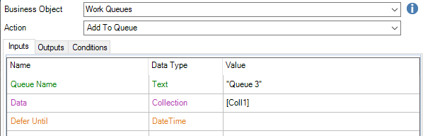

what is the difference between defferal date setting from control room, deffer action and defferal until in add to queue?

Defer Until parameter gives the digital worker or the robot this functionality to temporarily freeze the item via the automation workflow when the item is being just being added to the queue. One example I can give you is, let say you are automating a ticket assignment process in Service Now. Now in your process, let us assume that if the bot reads a particular comment box associated with the ticket it is working. Let say if the comment says something with a keyword as 'Manual Review'. In such a case, you may not want to directly process that item at that time, instead you may want to freeze that item till some required time interval so that any human can do the manual steps in between and then at a later point of time you can process that item. In such a scenario, ideally you would use this feature while you are pushing each ticket item from the Service Now platform directly onto Blue Prism. At the end of the day, everything would be added to the queue but the bot wont actually process such tickets which are differed right at the beginning when they got added.
