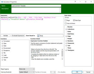

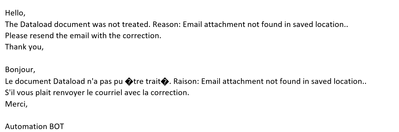

I have a requirement to send exception/completed emails. The body of the email is comprised of both English & French. So I am using a template to send emails. And using load Binary text function. When email is sent some of the French letters have ? at the top. Can you please suggest something to resolve this. Thanks.

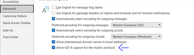

The body of the email that BOT needs to send is saved in a .txt file. This body consists of both English & French. And there is exception details or other information that needs to be replaced while BOT is sending email. I am using Load Text file function in a calculation stage to read text from that .txt file. Then replacing the exception details that I am getting while process is running. I also tried to chnage Outlook settings regarding that UTF-8, but still gets some weird errors on mail.

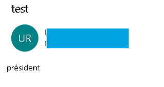

But, if the text is a template, try to replace in the txt the special character by his entity name or entity number, you can check a list in here: https://psdtowp.net/html-codes-special-characters.html
For example, if you want to write 'président'
you should write something like 'président' or 'président' both should work as it is compatible with html
Regards.
