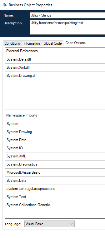

Hi Avinasi,
Thanks for the info. Pls Check the attachments which shows errors and code options.
Vinod Kumar
Hi Vinod,
This is what I have as the imports. Do you still get error with below configuration?
Shashank Kumar
Singapore
+6581326707
Yes Shashank,
I have the same imports in my object. Still getting same error.
Vinod Kumar
