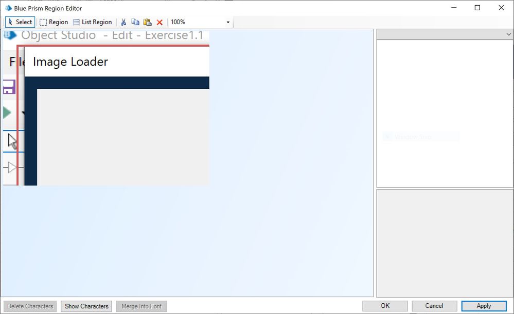

I'm using BP on a laptop with my system display scaled to 200% (default setting). The problem is I cannot spy regions properly with this - I will only get half the image showing up in region editor if I do this. Setting my display to 100% works but then everything on my desktop is so tiny I can barely read it. I've tried modifying various compatibility and DPI settings for BP application but no luck. Does anyone know a fix or workaround for this?
FWIW I'm running on a surface pro 5 with windows 10.

Thanks for your reply. The production environment is 200%. The problem is in application modeler - when I have a resolution set above 100%, it crops the image. So for example at 200%, the image is cut in half (100% / 200%). Zooming in and out in region editor doesn't change it, the image is cropped. I just now tried to re-import the "Utility - Environment" and actually the problem got worse, it now gets half the desired region but also grabs parts of the screen that are outside the bounds of what I selected. I'm not sure why that affected application modeler behaviour tbh, maybe just a coincidence.
The only workaround I've found is to keep re-adjusting my system display settings to 100% when working in region mode, but that causes other problems since when I go back to 200% it will have incorrect coordinates.
Attached image is an example of the problem from the BP surface automation training course. "Image Loader" application window was captured with region mode, when windows system display was set at 200%.
