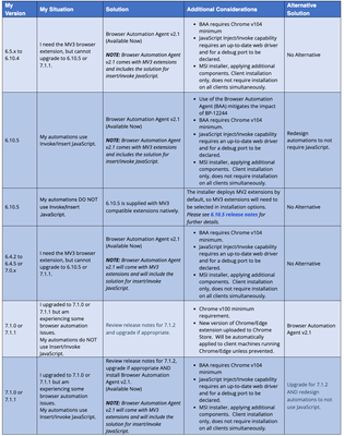

There have been historic problems with Invoke Javascript on different versions of Blue Prism what version are you using this may be a factor to check.
There is a new function in the navigate stage called 'Invoke Javascript Event' which might work better? It seems to require less code than the traditional route. Check out the link to an article which might apply to you.
https://support.blueprism.com/en/support/solutions/articles/7000078862
Hope this helps but more detail on some of the things in the table would hopefully get you closer to a working solution.
