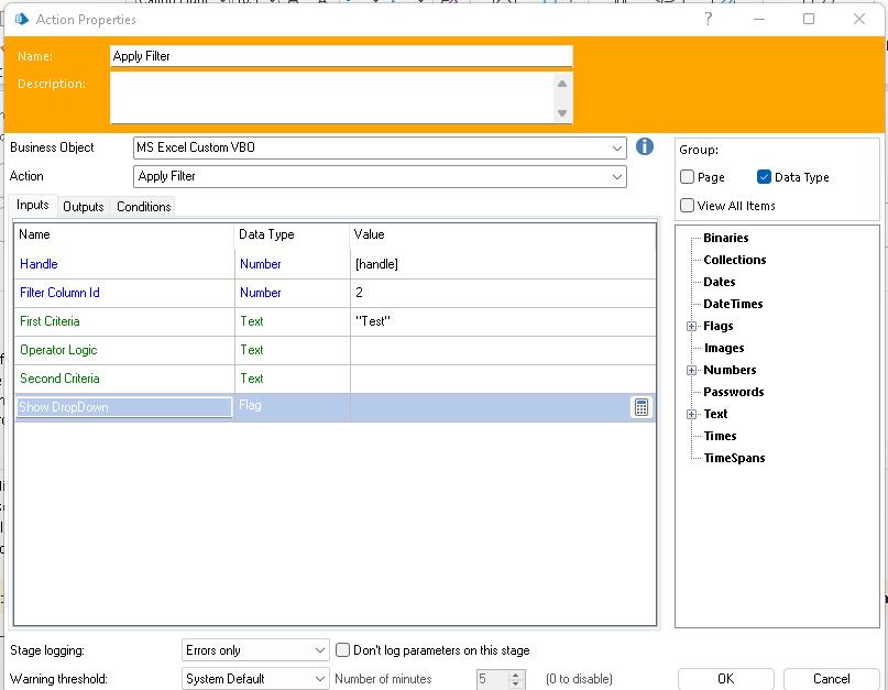

Hi Geoff / Eric
Thanks for the feedback.
The original file contains just over 54 000 lines of data.
We are using the Apply Filter Action, where we provide the filter column ID. Example column B and the ID used is 2
Then we are providing the string value we looking for. Example "Test", I have also tried "=Test" just in case. I left the bottom 3 inputs blank.
The stage before this I activate the worksheet and apply an AutoFit function just to validate visually that the VBO is working and that I am on the correct sheet.
I also tried a smaller file of just 110 lines and get the same error.
Using the code in the VBA module in the excel seems to work, but I cannot get it to work from the VBO for some reason. (Probably one of those "ID - 10 - T" type errors) 😊
