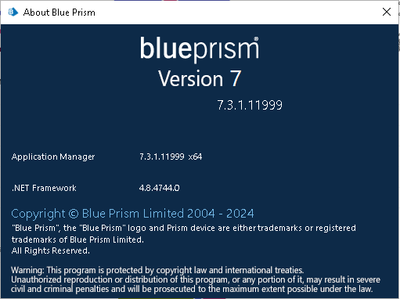

From the "About Blue Prism" popup I see that:
Blue Prism 7.1.1 utilize .NET Framework 4.7, while Blue Prism 7.3.1 utilize version 4.8.4744.0
