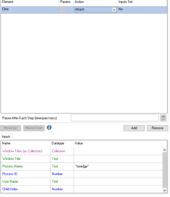

I'm having issues at the moment attaching to Edge running in IE mode when I step through a process (F11),  but if I step over (F10) the same stage , the process attaches successfully to Edge.
The error when stepping through is   'Attach' - More than one application matched the criteria'
The attach action is --

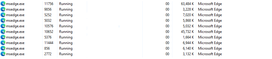

I know the issue can be that msedge opens multiple entries in task manager , my task manager shows this

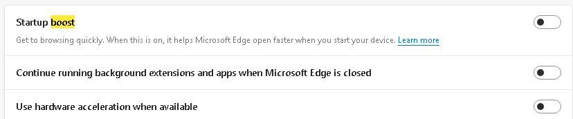

To prevent multiple entries in Task Manager I have also disabled boost mode

Worked around the issue by using the Window Title Input
