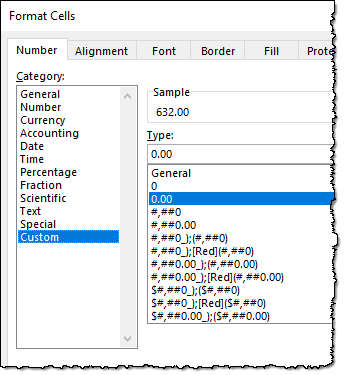

You can use the formatting code "0.00" to get what you are looking for (if negative sign is okay).

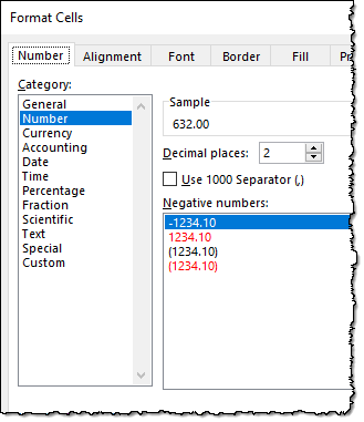

To find the codes that the "Format Cell" action (from BP's "MS Excel VBO" VBO) will accept, you can prototype it in Excel's "Format Cells" dialog:
And then select the "Custom" category to see the proper formatting code:
