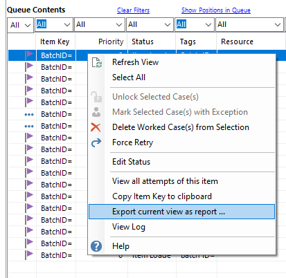

How can we export the queue data from the process the same as we do it manually from the control room?
My need is that the manually generated report and automatically generated reports from the process both should be in the same format. How can this be achieved?

There is no direct way but you can create a customized process to get those details. You can get all completed and exception items from the queue and then use Get-Item Data to give all the details displayed in the control room.

I also can't recall any direct way to achieve this. As suggested correctly by @_Amlansahoo, you need to fetch the details from Work Queues object and then modify accordingly based on your needs

Yes right, that is always an option but I was wondering if there is a quick utility that replicates the same manual export option available in CR to be used inside the process as well. I mean the function is there in CR but not at the studio level. Such an option could ease reporting extensively.
