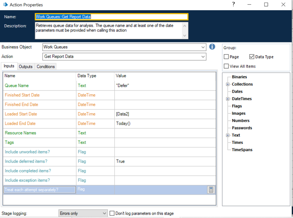

Hi
You can get defer items by using get report data
 refer below ss and provide details required , output will collection of item ids , also get item count based on the count you can proceed
Regards
