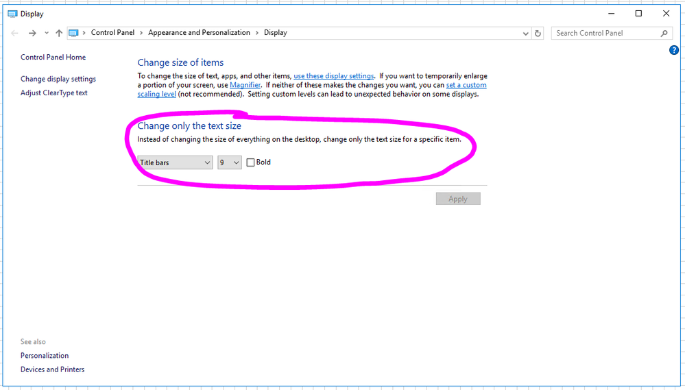

If you are looking for making bigger the entry platform, you need to change this from the Windows configuration.
Here you have a full guide to achieve this: Change the size of text in Windows
Basically, you change the font size from the Appearance and Personalization menu
(In the control panel, go here -> Control Panel\Appearance and Personalization\Display)
Hope this helps you!!
See you in the Community, hasta luego 🙂
