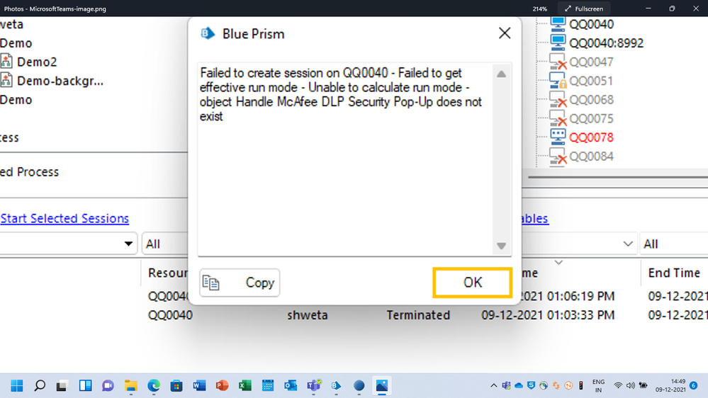

Hi all,
I'm Getting an error while Executing a session regarding McAfee, even i'm not having any McAfee Software on my machine. Can someone tell me how to resolve this issue.
"Failed to create session on QQ0040 - Failed to get effective run mode - Unable to calculate run mode - object Handle McAfee DLP Security Pop-Up does not exist"
Thank you.

The error indicates that one of the VBOs required by the process is not in the environment.

HI Sridhar,
Please check all the dependencies for that process. And also check if any new object is overridden in recent times .
