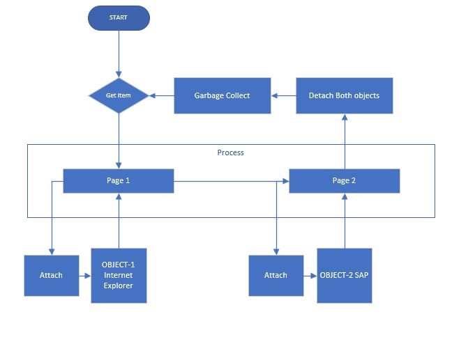

Hi Team,
This is a high level lay out for one of my project, which runs 24/7.
Theses are few details.
1- Object 1 , mostly works on HTML mode.
2-Object 2, 95% works in SAP mode.
  5%- in UI mode.
Problem:-
Bot runs good however, it takes time to identify the 5% of UI mod elements. The time gradually increased from 30 secs to 900 secs .
Fixes tried:-
1. Adding garbage collector.
2. Detaching objects
3.Killing IE and SAP.
4. Restarting System
Additional Observations:-
> Each time we stop the BOT and restart it process the 1 Items with comparatively less time ~ 100 secs.From 2nd item onwords again the slowness increases and it reach to ~900 secs
Please let me know if you need any additional information regarding the design.
