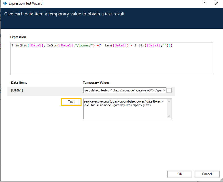

I am trying to extract the name of .png from the below span element
[Data1] =<span style='width: 24px; height: 24px; margin-top: 3px; margin-right: 6px; margin-bottom: 3px; vertical-align: middle; display: inline-block; position: relative; box-sizing: border-box; background-image: url("/assets/icons/service-active.png"); background-size: cover;' data-tb-test-id="StatusGrid-node1-gateway-0"></span>
output should be: service-active.png
[Data1] = <span style='width: 24px; height: 24px; margin-top: 3px; margin-right: 6px; margin-bottom: 3px; vertical-align: middle; display: inline-block; position: relative; box-sizing: border-box; background-image: url("/assets/icons/stopped.png"); background-size: cover;' data-tb-test-id="StatusGrid-node1-gateway-0"></span>
output should be: stopped.png
I tried this, but unable to extract the required output.
Any help would be highly appreciated.

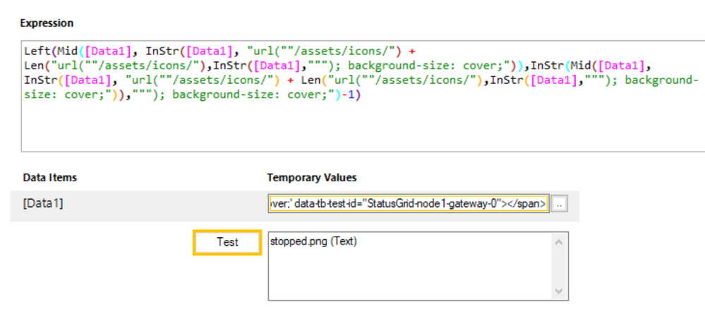

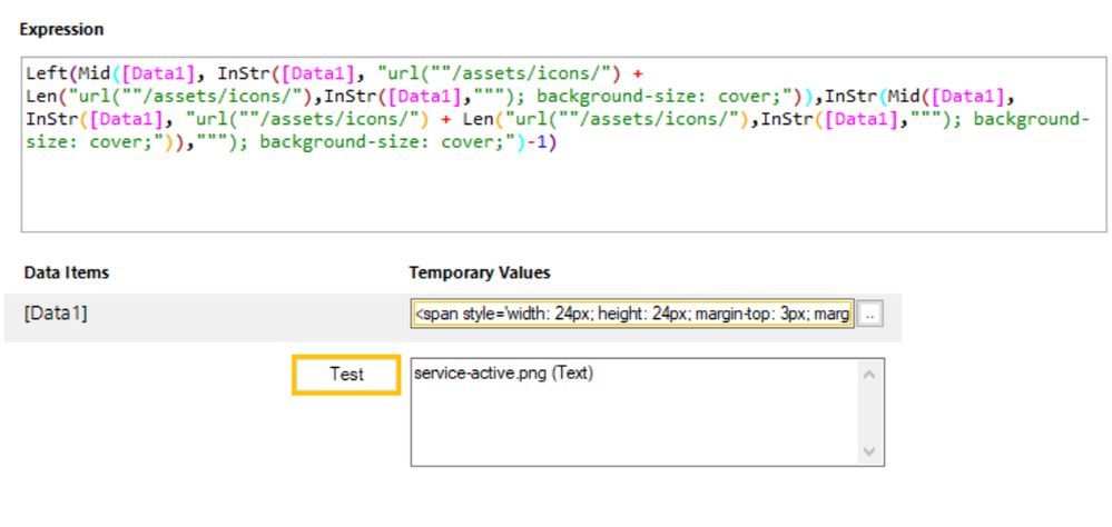

Hi @Roshini Syed,
You can use the following calculation expression and it should work for both of your use cases:
Please find the below results for your reference:
Use Case I:
Use Case II:
Left(Mid([Data1], InStr([Data1], "url(""/assets/icons/") + Len("url(""/assets/icons/"),InStr([Data1],"""); background-size: cover;")),InStr(Mid([Data1], InStr([Data1], "url(""/assets/icons/") + Len("url(""/assets/icons/"),InStr([Data1],"""); background-size: cover;")),"""); background-size: cover;")-1)
Use Case I:
Use Case II:

17-05-22 05:12 PM
Hi @Roshini Syed,
Use Case I:
Use Case II:
Use Case I:
Use Case II:

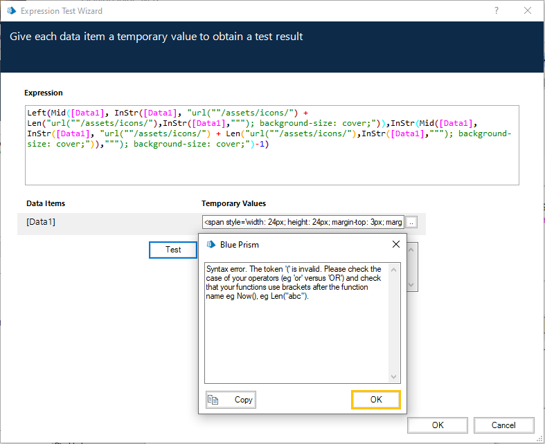

Hi Devneet,
Thank you for your Prompt reply, getting below error while evaluating expression
Any Suggestions please?
Roshini Syed
Roshini Syed

19-05-22 12:37 AM
Hi Rohsini,
I tried to copy paste my formula again and I faced no errors. I think while copy pasting the formula directly you are getting some enter characters in between. Can you try to remove them and try this once again, this formula should definitely work
