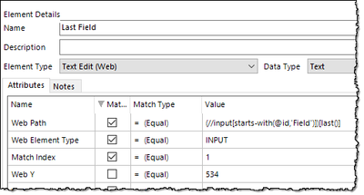

The way I would recommend is create an element that uses an XPath expression the would give you the last element that matches those IDs:
(//input[starts-with(@id,'Field')])[last()]

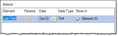

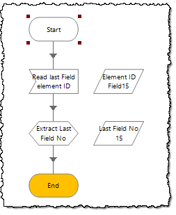

With either method above, you can then use the Get ID action in a read stage to retrieve the ID of the that last element to parse out the number of fields.
